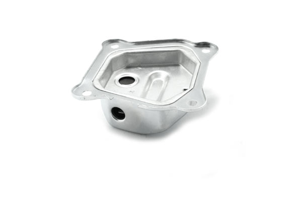

This hole is a port for a valve inside the rocker cover which releases positive pressure (a build-up of pressure inside the valve cover). You can see how the hole operates in the following picture of the rocker cover upside down:

If you're looking for a lower cost option, the way our stage 2 performance race builds are done is to use a right-angle ignition lead end cap, drill the cap out and fit a piece of fuel line inside. That is then pushed into the open port/hole on the valve cover and the fuel line dangles down. This will allow pressure to release and vent into the atmosphere just like without it, but adds the protection of any airborne objects, stopping them from falling into the hole. The only way anything can get inside the port/hole is for it to travel up the fuel line (Not very likely). However, this does not include a filter and is more likely to fail where scrutineers are more critical of ventillation control. It's always best to use the complete filter system.
