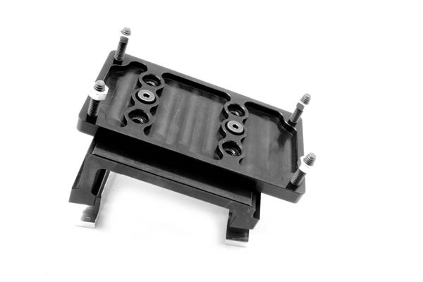

I recently bought this engine mount to avoid the hassles of adjusting chain tension and engine position. This has made things so much easier and quicker to achieve minor adjustments.

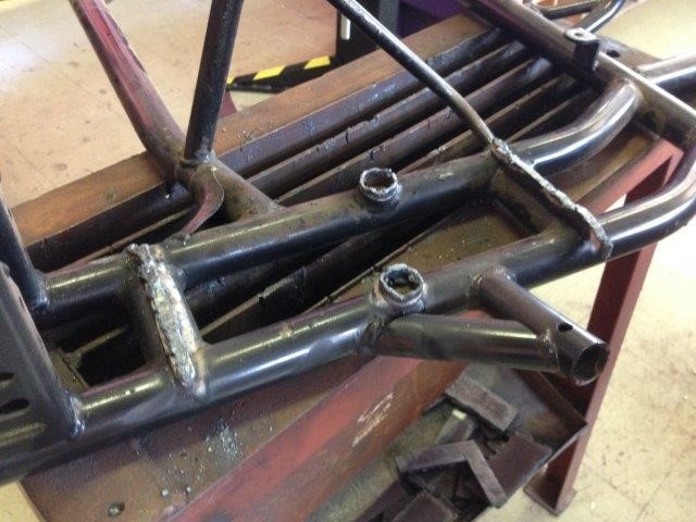

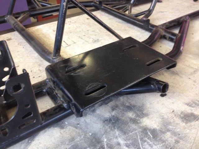

The only issue is that I had to cut and grind the existing plate off the frame for the new mount to be positioned. This was only 30 mins work but will save me hours in the long run and a lot of frustration!
See the images below to see the before and after and process.
Below is the frame with the engine mounting plate removed. This can be done with a grinder with cutting wheel or an oxy-acetylene torch.

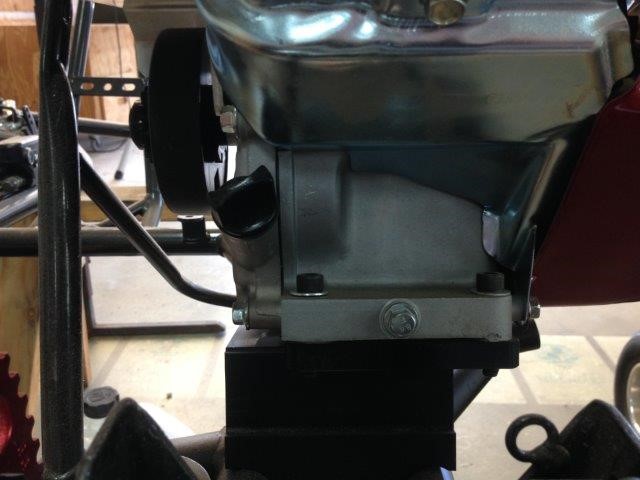

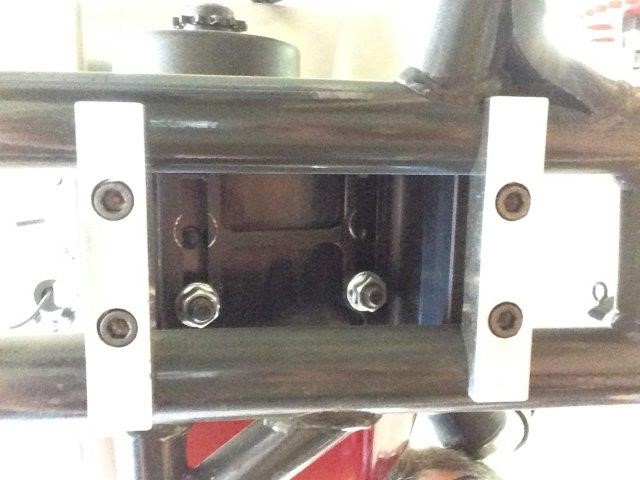

This image below shows the new mount installed.

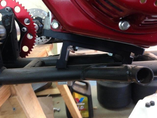

(Below) Another view from the rear.
(Below) Another view from the side.

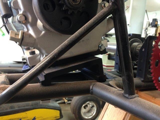

(Below) Another view from the front.

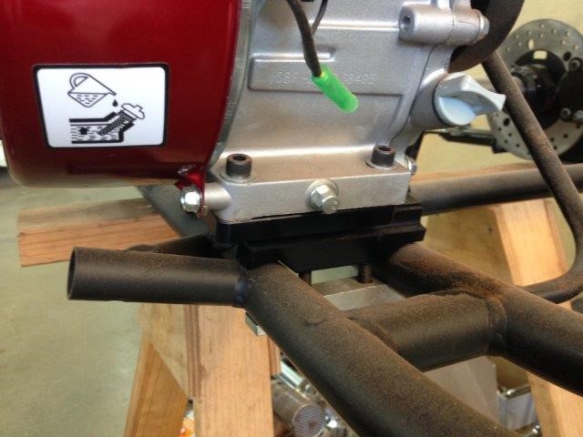

(Below) Another view from underneath.
