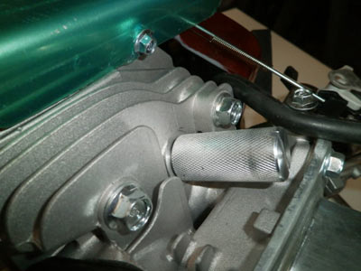

INSTALLING THE PISTON LOCKING TOOL
1. Wind the tool into the spark plug hole as far as possible by hand
2. If it's the first time you have used the tool, you may find it difficult to wind in after a six or seven threads. This is because there is sometimes some residue from the manufacturing process of the billet on the thread of the tool. Use a large flat-head screwdriver to wind the tool in further until you feel it touch the top of the piston or it winds it's thread completely in.
The screwdriver also helps if you have a recessed plug, or there is an airbox and/or exhaust system in the way of getting your hand inside.
3. If the piston locking tool doesn't wind in very far before it hits the top of the piston, unwind it completely then turn the crankshaft 1/4 turn at a time by connecting a socket and ratchet or spanner to the retainer bolt on the end of the crasnkshaft and re-check. This will relocate the piston so that it is further down the bore and allow the tool to wind in completely.
4. Once the piston stop is all the way in, wind the crankshaft ANTI-CLOCKWISE slowly using a ratchet and socket until the piston locks on the tool (you'll feel a very light thud) - WARNING DO NOT WIND TOO FAST or you risk damaging the piston stop tool and/or piston. Generally the softer billet alloy will not damage the piston, but if you wind it in hard enough it may dent the top of the piston.
