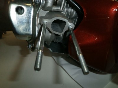

Remove the stock Air Filter & box, Muffler, and Fuel Tank from your engine.

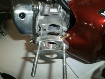

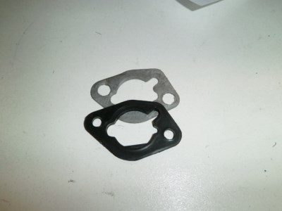

o Install the sandwich plate first. Gaskets are now included with the kit! Ensure that the gasket closest to the carb (bottom one) has a hole where the milled recess is on the sandwich adaptor or the system will not work correctly. Install the top gasket (D shaped centre) against the inlet manfold, then the Billet vacuum sandwich then the gasket with the small hole. The picture below has the gaskets oriented correctly for correct fitment when looking at the engine as in the picture above.
**PLEASE NOTE** The silver part below has now been updated to a BLACK bakelite version which provides superior heat insualtion and clips to retain the vacuum lines safely. It is installed the same way.
***NOTE: If you experience starting or running problems after installing the kit, double and triple check this step paying close attention to gasket order, orientation, and sandwich plate orientation ***

o Feed the gaskets and sandwich plate on as shown
*** ENSURE THE RECESSED SIDE OF THE SANDWICH PLATE FACES THE CARBURETTOR and that the flat side of the plate faces toward the manifold/head***

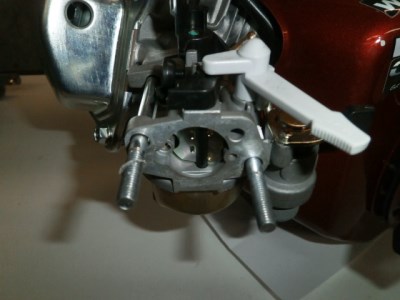

o Install the carburettor
o .jpg)

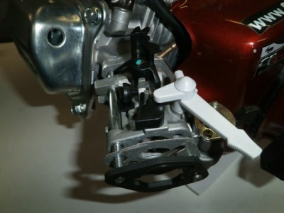

o Install the final gasket and the rubber retainer gasket as oriented below
o .jpg)
o Install the rubber gasket (orient the gaskets so that the cutout faces the top right of the carb bore and does not cover the small hole at the top right of the carb bore)

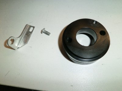

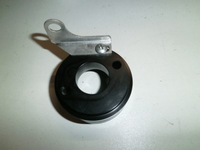

o Assemble the choke retainer bracket and venturi by installing the M5x10 Phillips head screw into the back of the venturi
o
.jpg)
 .jpg)
o

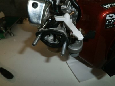

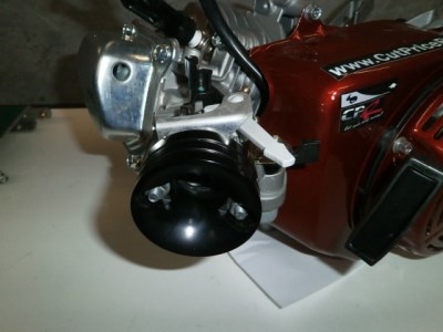

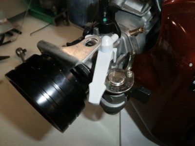

o Slide the assembled billet venturi onto the studs and set the bracket so that it slides over the top of the plastic choke lever - it does not need to actually touch the lever, just retain it so that it does not slip off the shaft.
o
.jpg)
· Install the two M6 retainer nuts on the studs and tighten snug to hold the billet venturi in place
o .jpg)

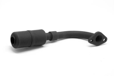

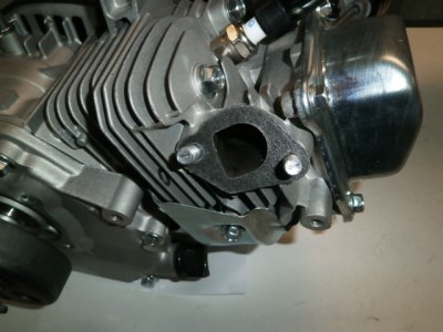

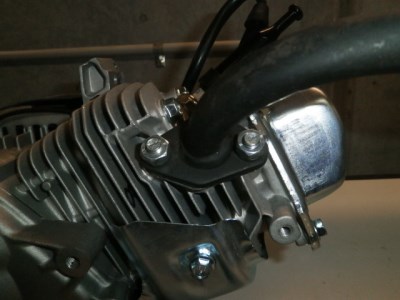

· Install the header pipe
· .jpg)
o If your muffler was assembled by us, you will install the entire muffler assembly. If your tip and header pipe was supplied separately, just install the header for now and then screw the tip into the header at the end

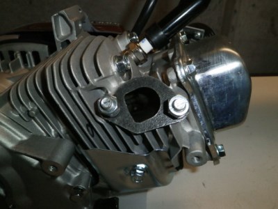

o If you replaced the nuts on the exhaust studs on the engine when you removed
o .jpg)
o .jpg)
o the stock exhaust system, remove them now
o If your exhaust gasket is still in good condition as pictured then you can re-use it. If it's burnt or broken, replace it with a new one. They can be found in our store and we offer genuine honda or aftermarket - the aftermarket model is quite inexpensive (try searching for exhaust gasket)

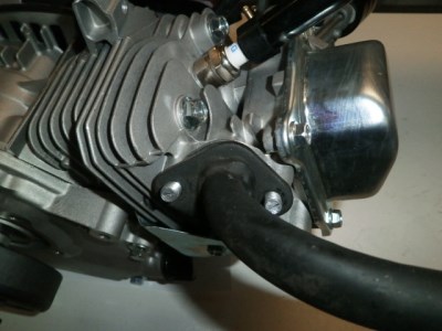

o Slip the header on with the bend toward the polished rocker cover
(away from the crankshaft)
o .jpg)
o Tighten the nuts down snug.
o .jpg)

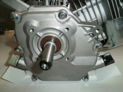

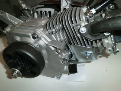

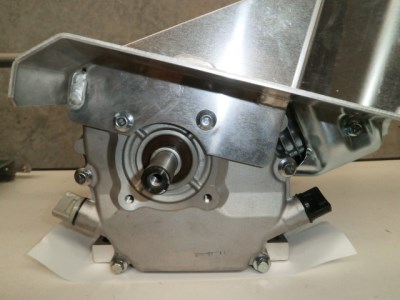

4. 4. Installing the new billet clutch & chain cover

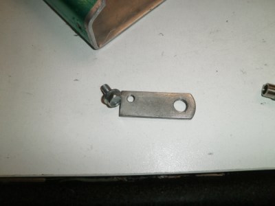

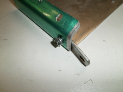

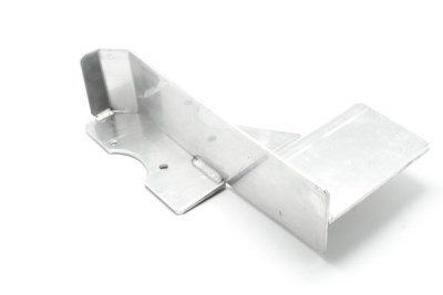

· Install the sideplate
o .jpg)
o remove your clutch (if fitted) using our clutch installation guide to remove & reinstall. (Click FORUM HOME at the top of our site, then navigate the forum Technical Information & Discussion > Guides > Gearing > GUIDE - Installing & Removing Clutches or click this link: http://cutpriceracing.com.au/phpbb3/viewtopic.php?f=14&t=798
o
.jpg)
 .jpg)
o
o Line up the two holes with the top holes on your sidecover and install the two XXXXXXX bolts as shown below
o .jpg)
o Reinstall your clutch.

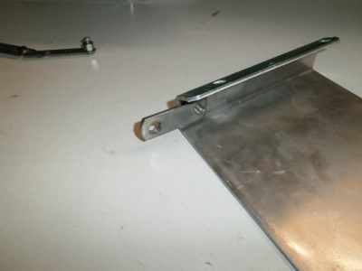

· Assemble the top plate
*NOTE: If you are installing your kit on a CPR S engine you will need to bend the part of the plate that kinks back, straight so that the bend is the same as the bend at the front of the plate but longer. The part that needs to be bent straight is the section you can see at the top in the picture below.
o Install the Throttle Cable seat plate on the top plate using the M6x15mm Bolt as shown below.
o .jpg)
o The plate is placed in behind the bent-over edge of the top plate with the small threaded hole away from the top plate base. Feed the M6x15 bolt through the top plate and screw it into the Throttle Cable Seat Plate and tighten.
