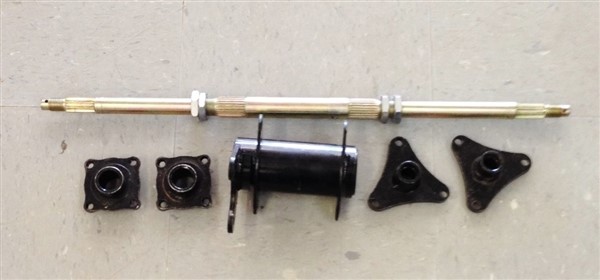

#1 – DON’T BUY AN ATV AXLE ASSEMBLY. It will give you headaches before you even start the build.
Above: Picture of ATV Axle Assembly (from google images)
While there are many different types of axle shafts on the market, and available cheaply, it is not a wise idea to select ATV style axle assemblies. They may be cheap, but you’ll end up with 2 significant problems - #1 you won’t be able to buy 3-bolt go-kart compatible rear wheel hubs, and #2 you will end up with imperial (inches) sized axle shafts which you won’t be able to find replacement hubs and carriers for and you won’t be able to fit go-kart style rear sprockets which will severely limit your chain and sprocket pitch choices and likely cause rapid burning out of your clutch. Not only this, but if you do end up modifying it in some-way, you will be left with a highly customised setup which you won’t be able to easily buy any replacement parts, certainly not from anywhere local. Even if you can find something, you’ll be stuck with replacement parts from online stores – so you’ve got no chance of getting something fast (or straight away if something breaks while you are out with friends). Then there is the fact that you’ll most likely end up with pillow blocks holding your bearings to your frame – while convenient, there are real dangers with doing this that can have serious effects such as destroying your engine but we’ll talk more about that further into this section.
So how do you know if you’re looking at an ATV axle assembly? There are a few dead give-aways such as:
- The shaft size is 1 inch or another imperial measurement (like ¾” or 5/8” or 25.4mm or similar)
- The shaft has splined ends for the wheel hubs rather than keyed straight ends
- The shaft is tapered (not a uniform diameter/thickness all the way along the shaft)
- (ABOVE – ATV splined and tapered axle shaft - Image from Google Images – gokartsupply.com)

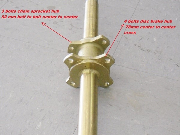

- 4-Bolt or 4-stud wheel hubs are included in the assembly (these have no chance of fitting the wheels required for your trike, and there are no adaptors available anywhere that will allow you to fit 3-bolt go kart rims – we get this phone call from customers all the time and it simply can’t be done unless you want to pay big dollars for an engineer to make you an adaptor.
- (ABOVE – ATV Wheel Hub - Image from Google Images – Blygo.com.au)
- Brake disc hubs are welded rather than keyed (this has other obvious consequences like not being able to configure the carrier locations as required)
- (ABOVE – ATV Brake Disc Hub & Sprocket Hub welded to the shaft - Image from Google Images uscoolsports.com.au)

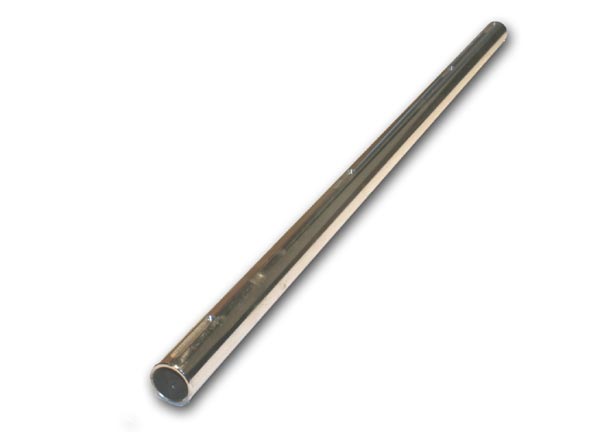

#2 – *DO* BUY A GO KART Rear Axle Assembly WITH A HOLLOW AXLE SHAFT if possible.
.jpg)
Generally there are two main types of axle assemblies readily available which are popular with drift trike builders. Both are go-kart assemblies. They can be bought with bearings, self-aligning holders and weld-on brackets (Cut Price Racing recommends this bracket style-solution) or with pillow block style bearings (we do not recommend pillow-block style kits). The main reason you should buy a go kart assembly is that you can easily source all the parts required for your trike, and all of them will fit with ease.
GO KART AXLES ACCEPT THE CORRECT SIZE RIMS AND TYRES FOR READILY AVAILABLE SLIDER RING PIPE
All go kart rear rims are a standardised 3-bolt hub pattern. This is a good thing because it makes it easy to find the correct rims. Because people all around the world have been using go kart axle assemblies to build their drift trikes, there are now companies selling pipe to suit the standard size tyres so you don’t have to re-invent the wheel (excuse the pun). You can even buy the pipe directly from Cut Price Racing in small quantities – like just a single pair, instead of having to buy many metres of the pipe. This means you can get high quality long lasting pipe which is properly cut and QC’d and perfectly round for a great price, rather than having to buy lots of low-quality thin soft material that wears out super-fast and vibrates your slider apart. You can read more about the best tyres and pipe to use further down inside this guide.
GO KART AXLES ARE METRIC SIZES AND ALL PARTS ARE READILY AVAILABLE AT GO KART SHOPS IF YOU GET STUCK
If you’re out enjoying your slider and have a hub or carrier failure, wouldn’t it be nice to be able to drive to the closest go kart shop and pick up a replacement (even if it’s a bit pricey). With a standard size go kart axle shaft in a metric size you can do exactly that! We do recommend you stick with the currently popular diameters though – don’t buy 25mm or 35mm if you are hoping to get spares from your local go kart shop. You might be able to order them from Cut Price Racing online, but those sizes are obsolete and are generally not supported by the smaller shops now. Soon those sizes may not be available at all and if they are they will be very expensive.
CHOOSE A 40mm HOLLOW AXLE SHAFT IF POSSIBLE SO YOU CAN BUY REPLACMENT PARTS EASILY AND CHEAPLY
Stick to Hollow 40mm axle shafts – these are the most readily available sizes and you’re more likely to find second hand replacement parts or even cheap new parts – choose a hollow shaft so that they are not heavy – solid shafts can weigh up to 3 times as much as a hollow shaft and due to their design they aren’t necessarily stronger. Even a 25mm solid shaft will outweigh a 40mm hollow. This means you'll have more weight in the back of your slider and it will be harder to control a slide.
Cut Price Racing 40mm hollow axles are stronger than most of the axle shafts on the market due to the special chrome coating system used on them to improve strength and longevity.

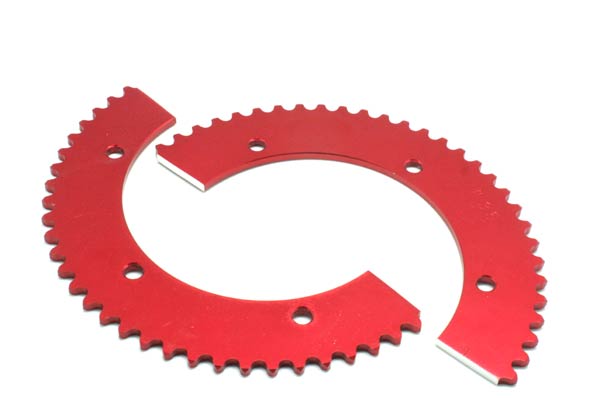

GO KART AXLES HAVE THE WIDEST RANGE OF GEARING (SPROCKET) CHOICES
The carriers designed for go kart axles are standardised and have been the same for over 50 years. This means that over the years many people have raced and used many pitches and sizes of sprockets. This gives the manufacturers scale of economy to produce lots of different sizes cheaply so in-turn they become more popular. The end result is that you can buy sprockets off the shelf to fit 420P, #35 and 219P (you can learn more about chain pitches here: http://www.cutpriceracing.com.au/phpbb3/viewtopic.php?f=14&t=28 and you can learn more about sprocket sizes here: http://www.cutpriceracing.com.au/phpbb3/viewtopic.php?f=14&t=10 ). We recommend choosing #35 gearing because it is the most convenient to fit and has the widest range of clutch and front and rear sprocket size options, ensuring you will find exact right gear for your slider and that you receive the best lifespan from all of your components as well as the greatest quality of hassle-free fun.

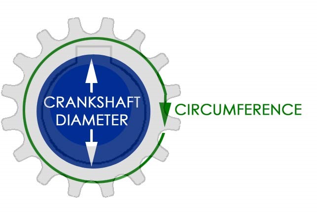

The outer diameter of the output shaft (crankshaft) of the engine where the clutch slides on dictates the minimum number of teeth that can be placed on to the clutch.
We refer to distance between teeth on a sprocket or the distance between pins on a chain as the pitch. This distance must always stay the same for the chain and sprocket to mesh.
As you can see from the diagram below, looking at the green line if we were to make the sprocket larger, either the size and distance of the teeth would need to change (this would change the pitch) or there would need to be more teeth on the sprocket to fill the larger circumference.
The problem with the 13hp engine (and all 9hp, 11hp, 13hp+ engines) is that they have a large crankshaft diameter (1 inch = 25.4mm) which means the least number of teeth that can be used in a #35 pitch is 15 teeth. This means your gear ratio will be much taller, and more problems will exist in relation to clutches burning out and poor performance.
Using an engine with a smaller crankshaft is the obvious solution, and smaller sprocket sizes are available for ¾” (19.05mm) crankshafts such as 12T or 13T. This will provide a much better gear ratio for your slider.
